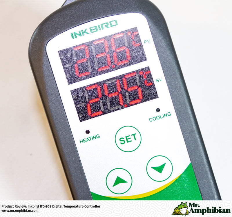

Hold “SET” for 3 to 4 seconds to begin programming.
Two digit codes appear on the top screen. Control the settings by using the up/down arrows.
Once you’re in the programming mode, you can press the “SET” button again to switch to other settings.
- “TS” stands for Temperature Set. This is the temperature you want the enclosure to stay at.
- “HD” stands for Heating Difference. This is how many degrees you will allow the temperature to fluctuate from the temperature set value.
- “CD” stands for Cooling Difference. This works like the heating difference but pertains the cooling element.
- “CF” stands for Celcius/Fahrenheit. This settings allows you to switch the temperature mode.
- This isn’t a how-to tutorial about using the INKBIRD ITC-308 but the bulleted section above will give you an idea of how to use it. It takes about 5 – 10 minutes to program and set up.

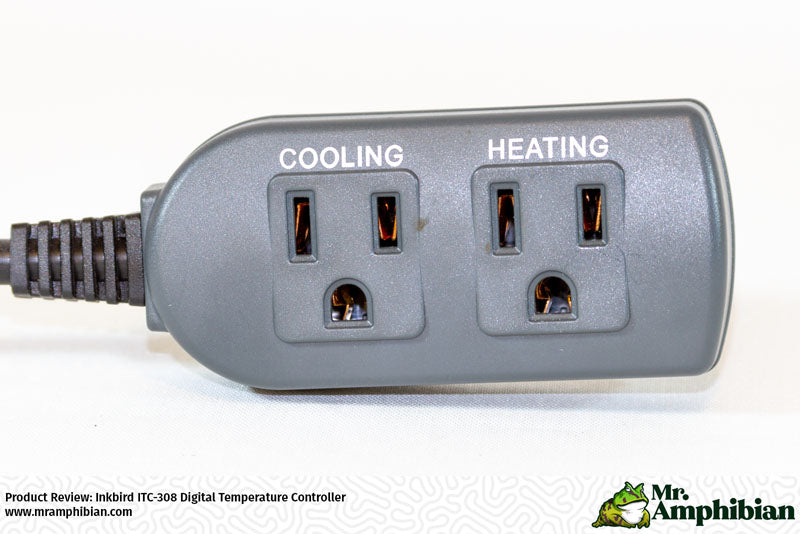

The most unique feature of this thermostat is the ability to use a cooling element. Now, most reptile thermostats control heaters only. That’s because cooling elements are relatively uncommon in the industry.
In fact, the only meaningful cooling device I know of are fans. Using fans in this hobby is problematic for two main reasons.
One, frogs are small, and placing a fan inside their enclosure can be fatal. You need to create a barrier to protect the inhabitant. A small fan on the outside pointed in is more common.
Two, fans will help cool the enclosure but they also decrease the humidity. Lowering the humidity can be problematic without having some way of combating it.
So, that’s why the cooling element might go unused for reptile and amphibian hobbyists. Still, it’s a great feature for the rare chance you use a cooling fan in your terrarium.

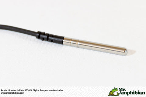

The temperature sensor is an average probe, comparatively speaking. What I like about it is that the cable isn’t overly stiff. It’s easy to work with and placing it where you want is simple.
